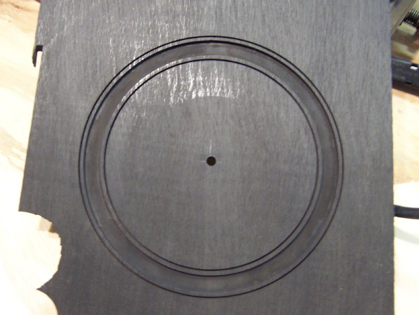

Well, I spent a couple of long days making my rosette for my brother's curly oak OM with bloodwood trim. It's very similar to one posted just a couple of days ago, but I wanted to show it off cause I'm proud of it.
First I joined two ebony headplates and sanded the joined piece down to about 1/8", then routed a groove for a piece of bloodwood.

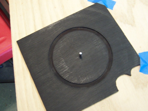

Next I routed two 1/32" grooves, one on either side of the big groove.

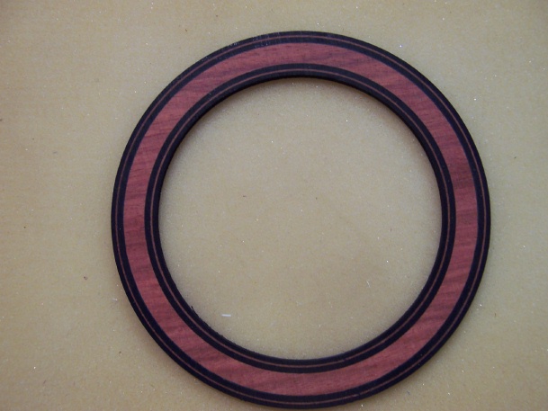

Next, I installed the pieces of bloodwood using black CA, and filled any open spaces with clear CA and ebony dust.

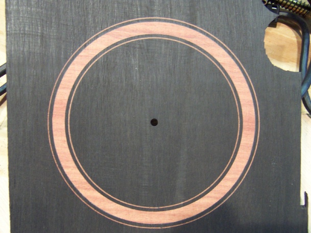

And, although it looks purple in the photo, here is the finished rosette with nothing on it.
Thanks for looking.

I can see that inner black ring as the inside edge of the sound hole. Any plans for that?

No, John, I didn't think of that, but I like the idea. This will only have about 1/16" of spruce showing. It would have been cool to take the ebony to the edge.

Okay call me dummer than a bag of hammers but what I don't get is how you inlayed the 1/32" piece of bloodwood? Or is that a piece of white purfling?
On John Kinnaird's comment -- couldn't you increase the radius of the soundhole by 1/16"? (Probably another dumb thought).

Anthony, that is 1/32" bloodwood. I actually made it by taking a piece of black/bloodwood/black purfling and sanded off the black from either side on the thickness sander. After cutting the 1/32" groove, I just placed the bloodwood strip in the groove and hit it with CA.
It would be possible to increase the soundhole size. I'll think about that as I haven't cut the soundhole yet.
